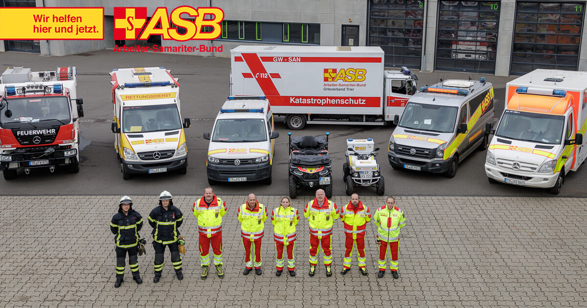

Thanks Andrew, but it doesn’t work for me (uploaded everything just now). In normal state the current submenu is not yellow and also at the last main menu item “Der ASB Trier” all menu items are yellow.
And in triggered state all menu items from the last main menu item “Der ASB Trier” are also yellow. The main menu items without a submenu are white on white, ok. But when I switch them to black, the menu items from the submenu are also black.
In the “not-Pro” version of Chroma everything worked perfectly:

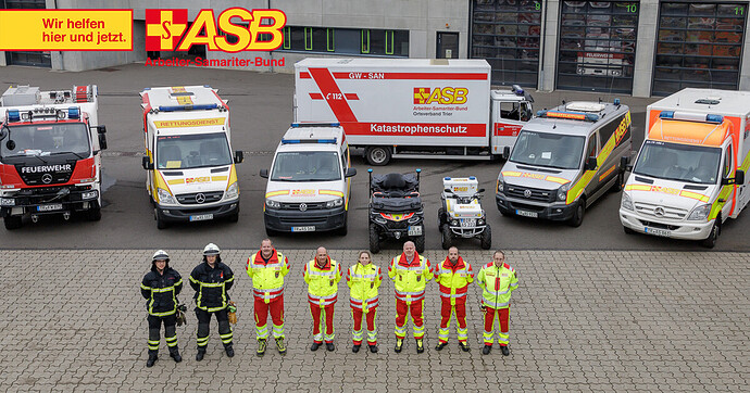

Yes, I’m quite sure that I’ve set up everything correctly.
Ha…, I’ve just seen you’ve already done so! :-) Thanks so much for that code, which works perfectly. So I’m now using the normal Chroma-site (not Pro) with that code (already added it to all pages):
https://www.asb-trier.de/2021/
Sorry for nagging you so long with this stuff. In the end the result is great, thanks to your constant, patient and professional support, Andrew. Highly appreciated!
