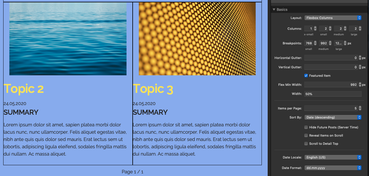

Horizontal or vertical spacing?
Horizontal. It stayed very similar to your first example. Iâll recreate the page and upload here tomorrow with my settings. thanks for your help.
Whatâs horizontal and whatâs vertical đ
The gutter left - right should be there.
The gutter top - bottom is missing. I will check that.
Now Iâm confused! Let me send you the link and youâll see. The left right gutter is there, just not working for me.

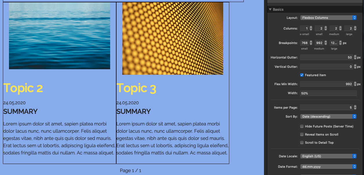

I experience the same issue as @Nigell ⌠and the stack settings of âmyâ Poster 2 stack look slightly different than what you have posted. There are settings for both horizontal and vertical gutter. The vertical gutter acts as expected, but the horizontal gutter does not increase the gap, but rather seems to add the spacing on the right side (like a padding or margin).

Just a tidbit more info: the gutter definition works fine in the âMasonryâ layout, just the âFlexboxâ layout (allowing a featured item) shows all columns being âleft alignedâ. If the columns would be âspreadâ or âedge to edgeâ, then the gutter setting might be working.
Itâs most probably a justify-content thing on the Flexbox, which works in the themes I tested, not in other ones. That should be easy to fix. I will check your demo file. Thanks.
