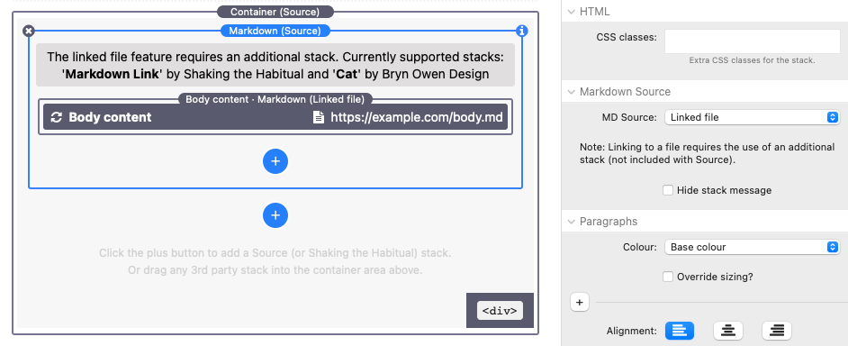

Had a play with a few things yesterday around this topic and have come up with what i think is a rather nice solution.
I put together a new little stack called Markdown Link that pulls in a remote (or RW resources) md file - this can work as a standalone stack anywhere. The nice thing though is that I made a tweak to the Source Markdown stack so that this new stack (or another such as Cat) can get dropped into it - therefore giving all of the styling control that the Source Markdown stack offers.
I don’t think Markdown Link stack really fits inside Source (as it is a php based stack which none of the others are) so it would likely be a separate download.
I’m still putting some finishing touches to these but if anyone fancies having a test / play with it then please drop me an email or message me here and i can pass on the stacks.
