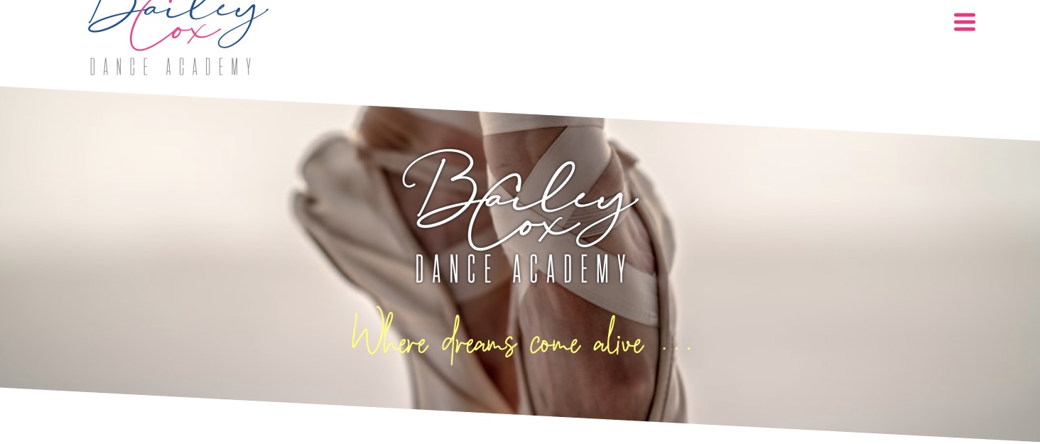

@tav Thanks Andrew but it doesn’t seem to allow me to use it to mask to an image as Sections Angle does:
The best way to do this is with a clip-path for which you can use Clipper (or just insert the CSS).
Here is a project with a SectionsPro in a Clipper. I’ve set the Clipper to a custom shape and to apply to a custom class which is the SectionsPro background image, this way the content will never clip were it to overflow the image.
Here is the project: clipper-sections-image.zip - Droplr
You can of course edit the clip path to change the slope or shape etc. Let me know if you need more help with this.
