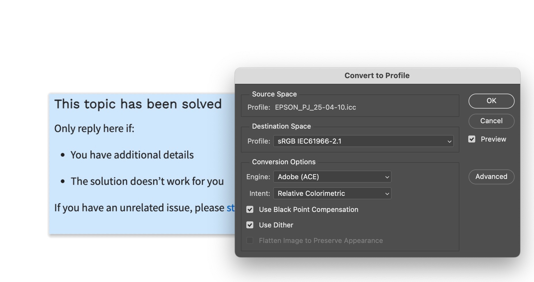

I suspect that where you are going wrong is that upon opening an image, it has to be converted to the correct colour space. Assigning a colour space / profile, or failing to, breaks everything.
Let’s say I screen grab said blue panel. I now need to convert from whatever my screen colour profile is, to a standard working space, usually sRGB. Do that and Hex values are identical to what RW gives me via the picker.
Ignore my current profile, Sequoia currently has a bug where it holds onto the last external display profile, hence my presentation projector. So my screen grab needs to be converted from display profile (EpsonPJ ) to sRGB

I appreciate your workaround works, but this is the correct way to do it.
Blue colour above, picked by RW colour picker. Colour swatch stored.
Screengrab (attached above) saved to desktop. Open in PS or A N Other colour managed app. Convert from Mac screen profile > Working RGB (sRGB)
Add Container plus to website. Set background to custom and select the stored swatch.
Add Screengrab to container - see result below.
There is no issue with RW colour picker (and I am not a RW fanboy as most know!)
If you want to extend an image, it has to be done in a colour managed way to work across all platforms.

The Apple colour picker which RW uses is effectively converting values to sRGB on the fly, hence why my methodology is working. I need to do some more testing when I have time.
