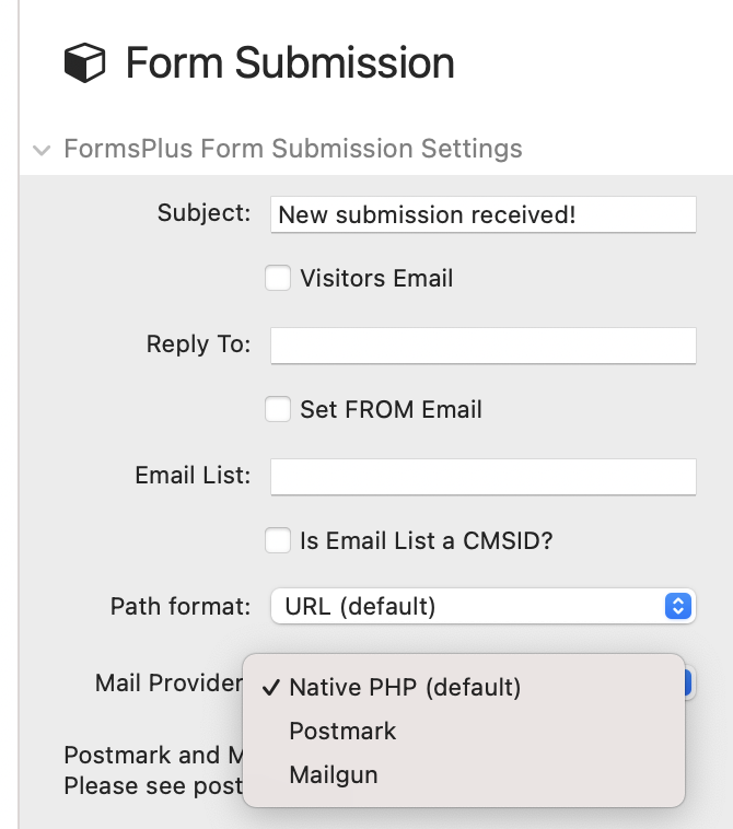

This isn’t a “host email issue”. This is an issue with HOW the contact form sends email. Gmail has now started enforcing valid SPF records for emails. MOST contact forms will forge (or fake) the FROM address using PHP’s built-in mail function. The mail software, however, signs the FROM address as root@server.example.com NOT the email address “faked” by the contact form. Therefore, the message fails the SPF validation that Gmail performs.
To avoid this, SMTP needs to be used to ensure that the email is properly authenticated and the FROM field matches and passes SPF validation.

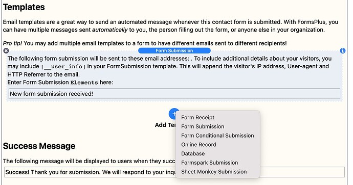

As a FYI, FormsPlus support SMTP (as well as Mailgun and Postmark).

Just a FYI, SMTP is not made to be used in conjunction with contact forms because it’s slow and not scalable. More HTTP friendly mechanisms are using APIs such as Mailgun (free tier), Postmark, SheetMonkey or FormSpark.
