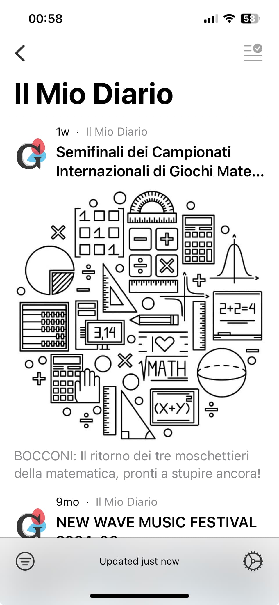

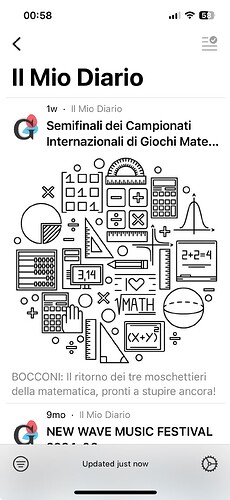

I also checked the site’s RSS on the “RSS Mobile” App,
it’s fine, it works and updates all posts, displaying date, title and image, even the link to the original page works.

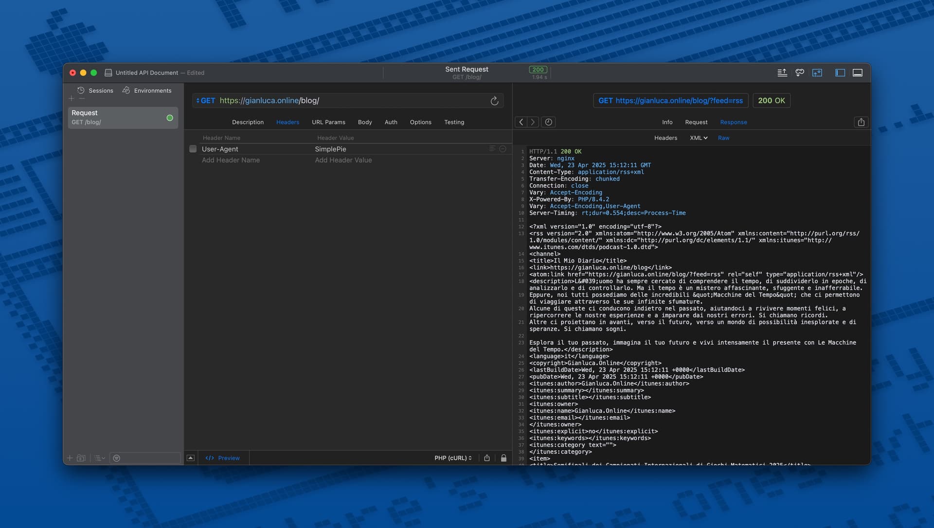

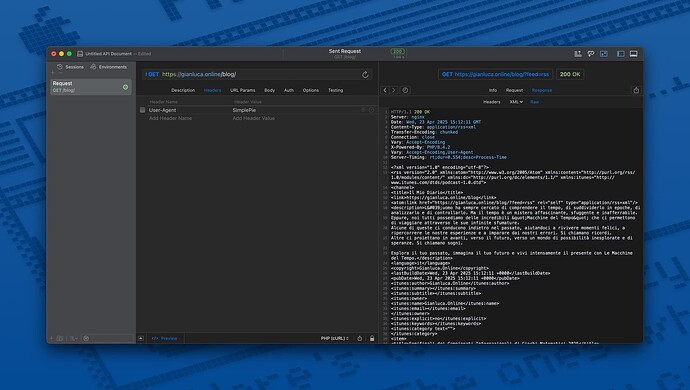

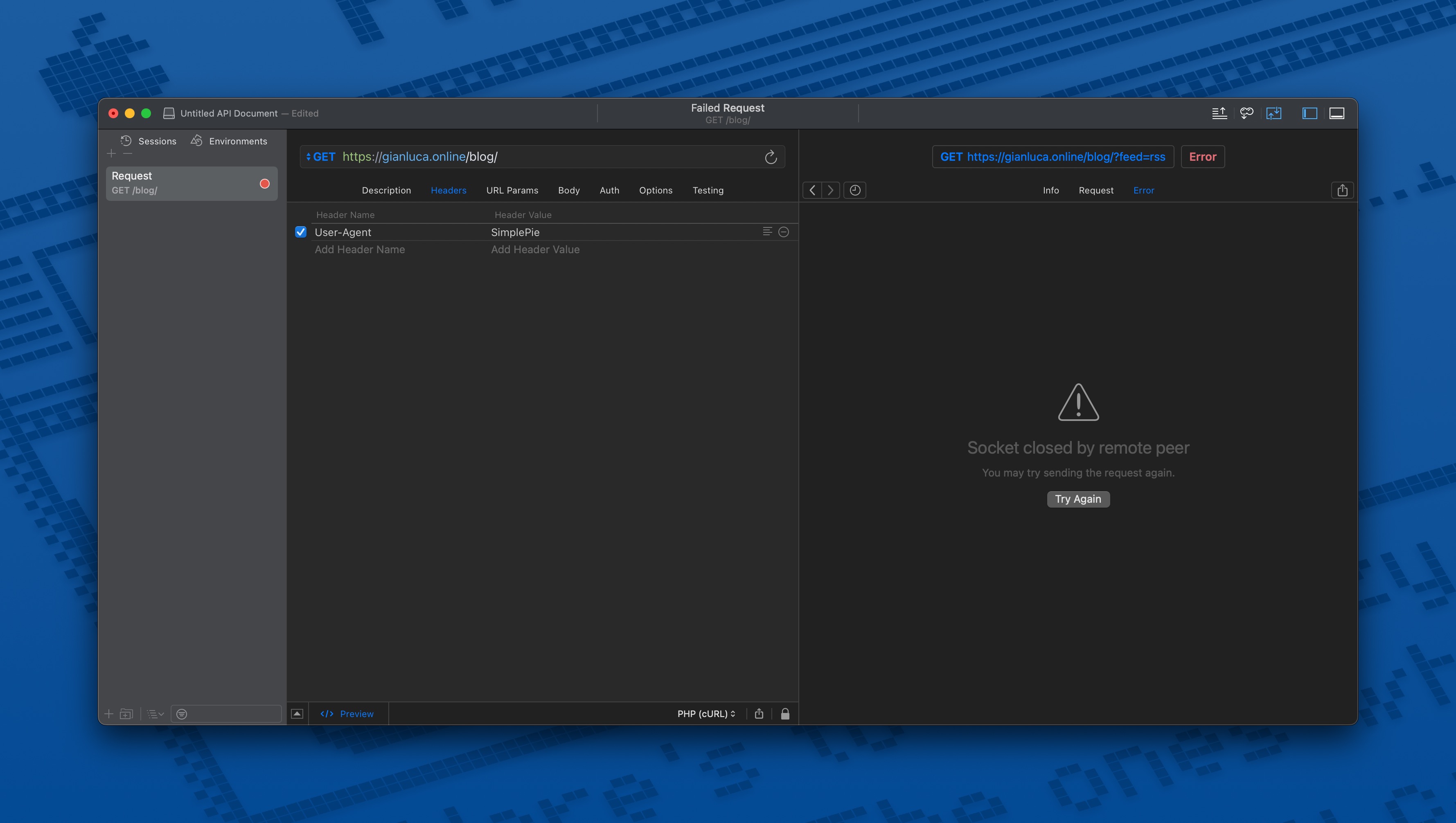

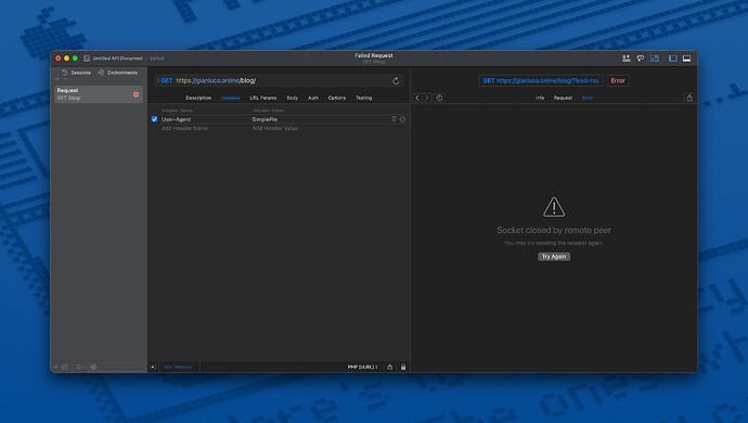

The host support clearly does not understand the problem. They are clearly blocking any request that has SimplePie in the User-Agent of the request.
Works (user agent not set)
Broken (user agent set to SimplePie)
