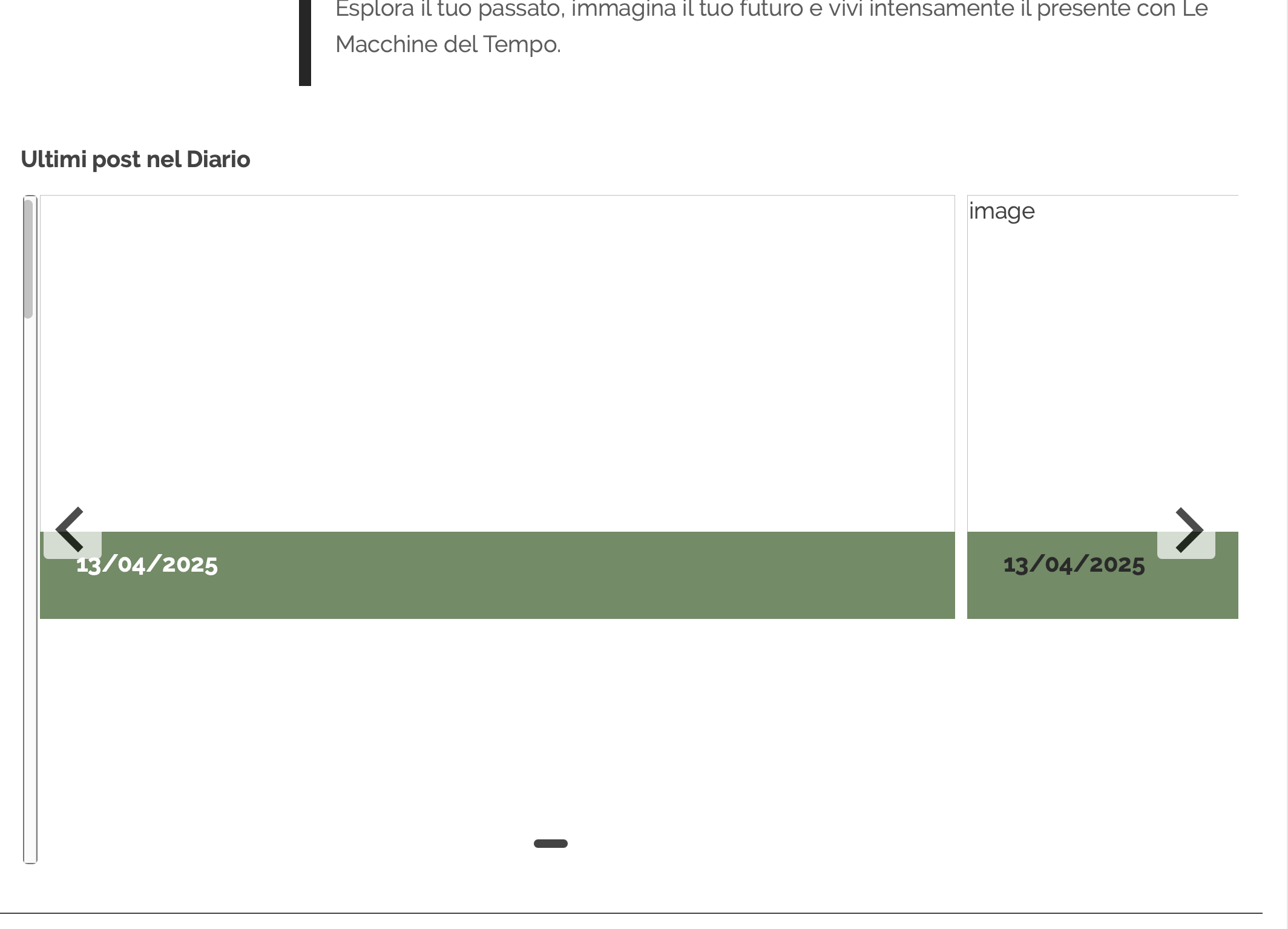

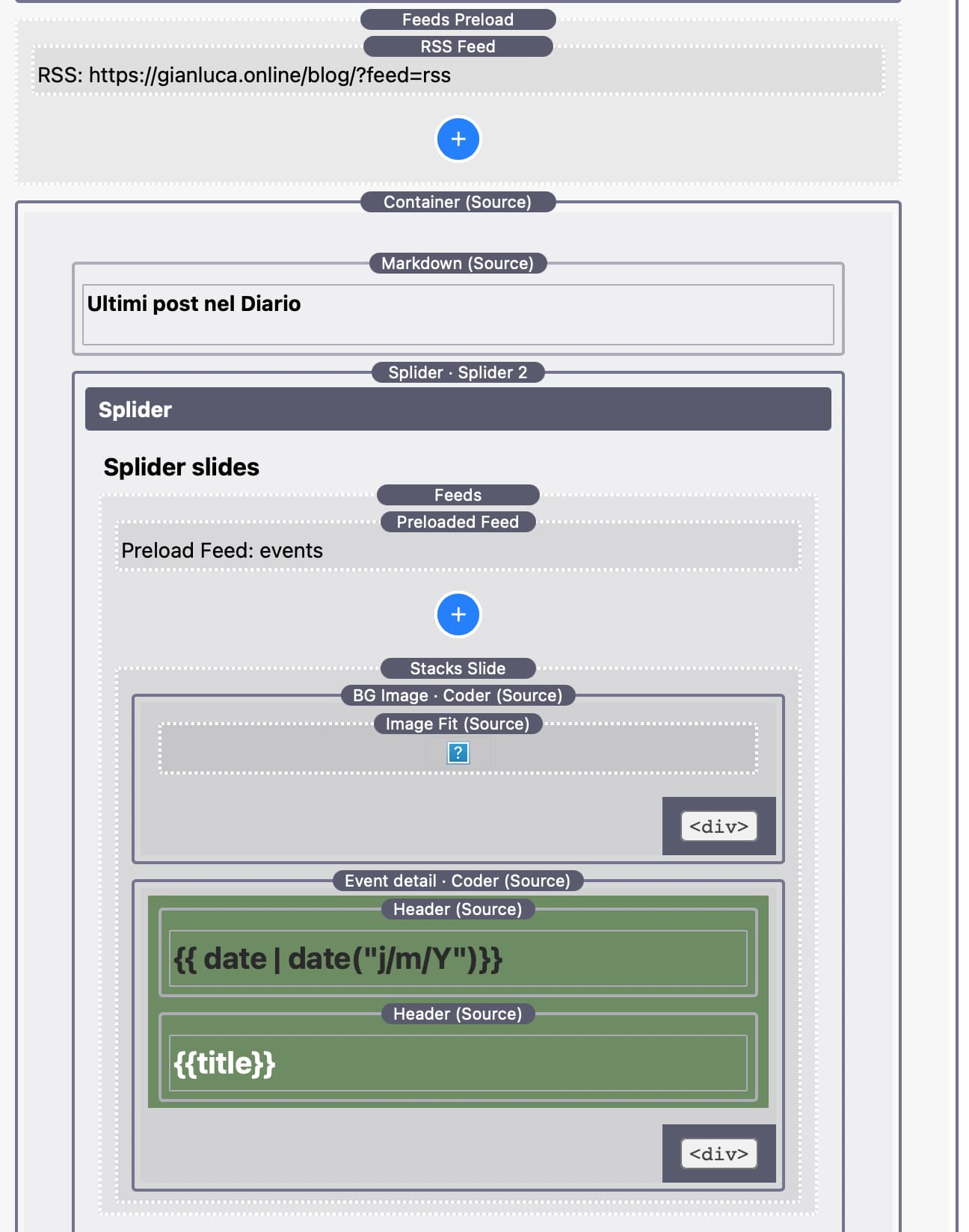

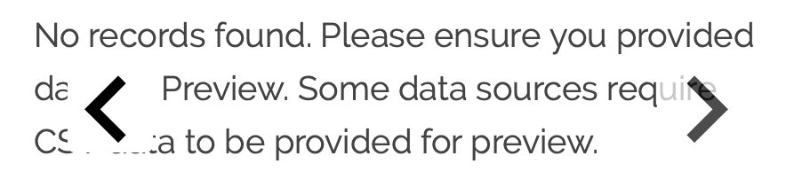

Here I did a test (in the " Ultimi post nel Diario" part) to visualize the problem, using “Feeds Preload”, “Preloaded Feeds”, “Splider 2” and “Source”, recreating the situation (before working) of failure
The strange thing is that if I put in the “Feeds Preload” a “CSV Feed” with the RSS url that was not found previously, incredibly it works (but I don’t see the images)…

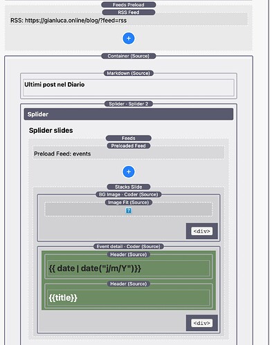

I made the projects following the source-plus_feeds-events.rw8
My project is also made with Source, but like I said, it is simpler than yours. However, I have a feeling that this issue is with Feeds, because your project used to work before the update. You could certainly try to engage Stuart, though.

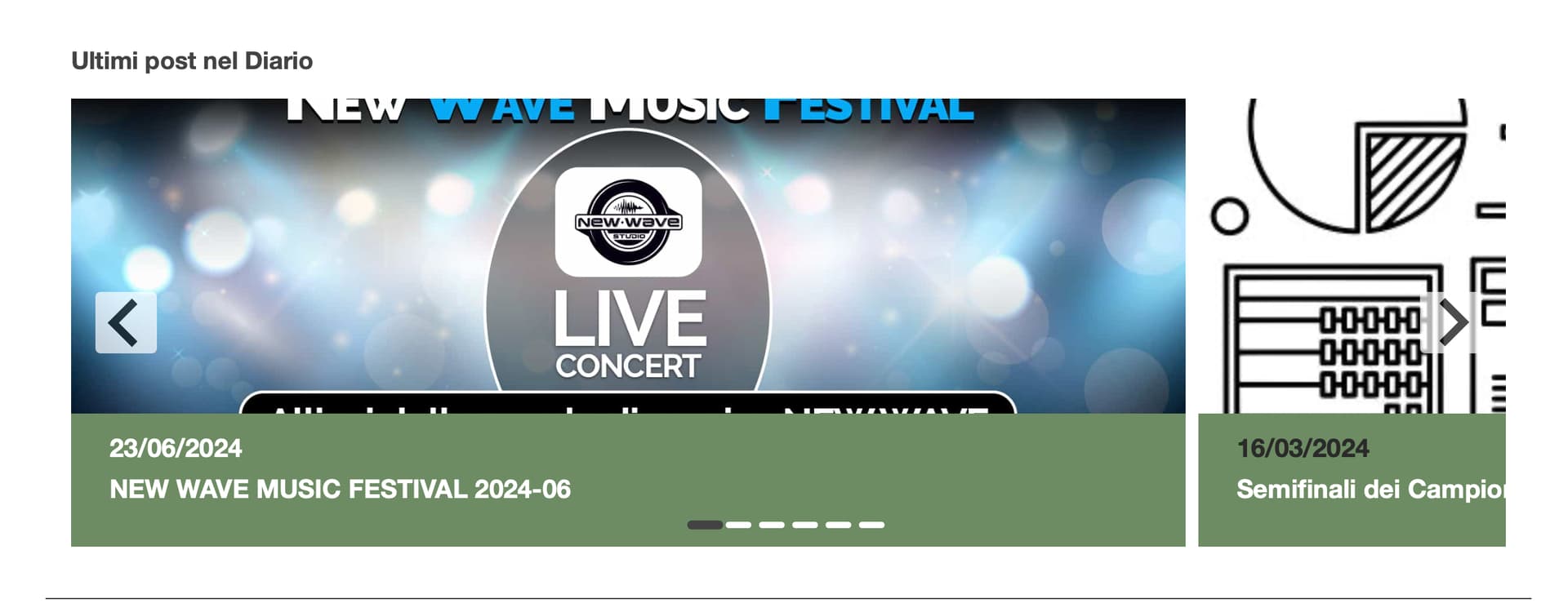

Yes, it worked perfectly.
The last 5 posts were displayed (with a jpg, date and title in each one.
You can also see from the web archive:
