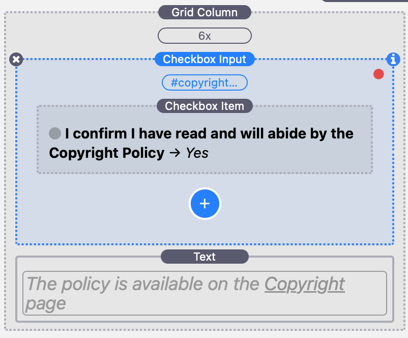

I don’t know a way to do that, I had a similar requirement to get the user to confirm they would abide by my copyright before submitting a form.
I use FormSnap which is similar and instead of a radio button I use a Checkbox Input to confirm my Copyright.
I remove any Subtext data from the stack and added a Text stack underneath it with some text and a URL link to my copyright page.

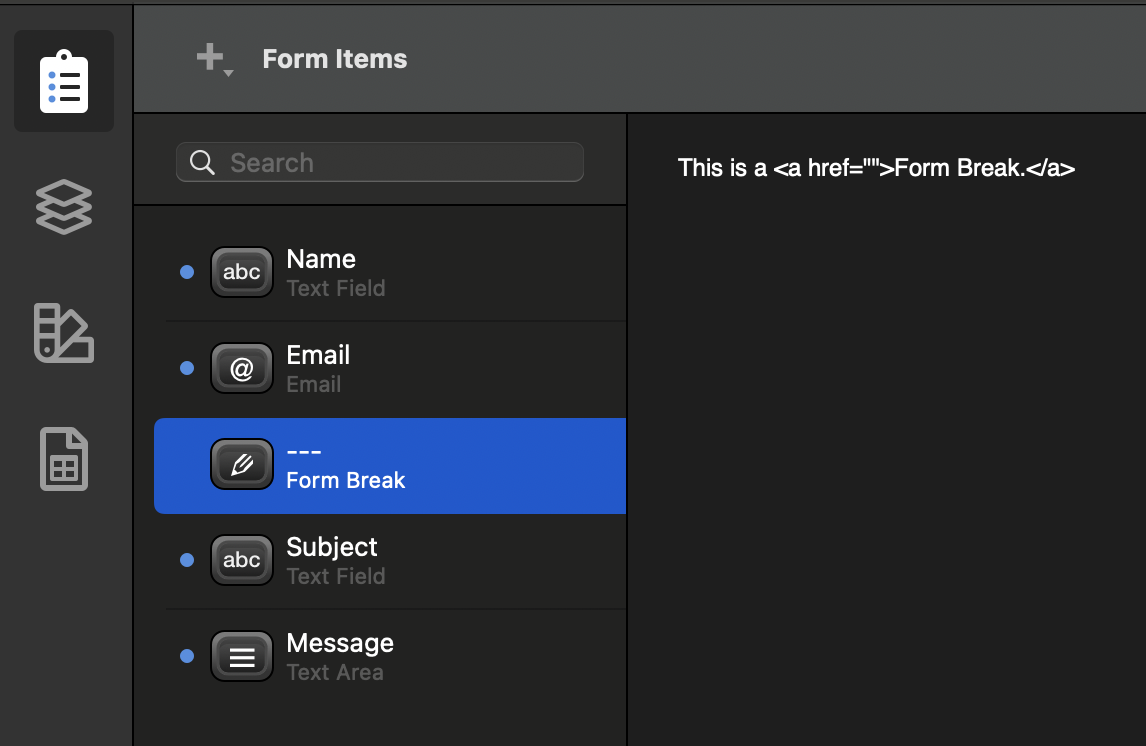

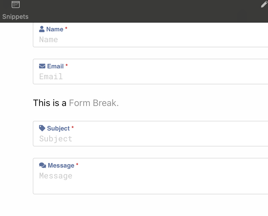

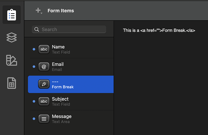

I think you could use a “Form Break” for what you need. In the content of it you can use HTML, for example for a link…
Form Break is definitely a good option. There is actually a link option at the bottom of the Form Break Window so very easy to link to the T&C page or document as you wish without coding.
Just make sure the Radio Button is mandatory. I don’t think setting validation to mandatory shows an asterisk as far as Radio Buttons are concerned so you can just add it below in the sub-text field.
Yes that is what I’m looking for! Thanks!
