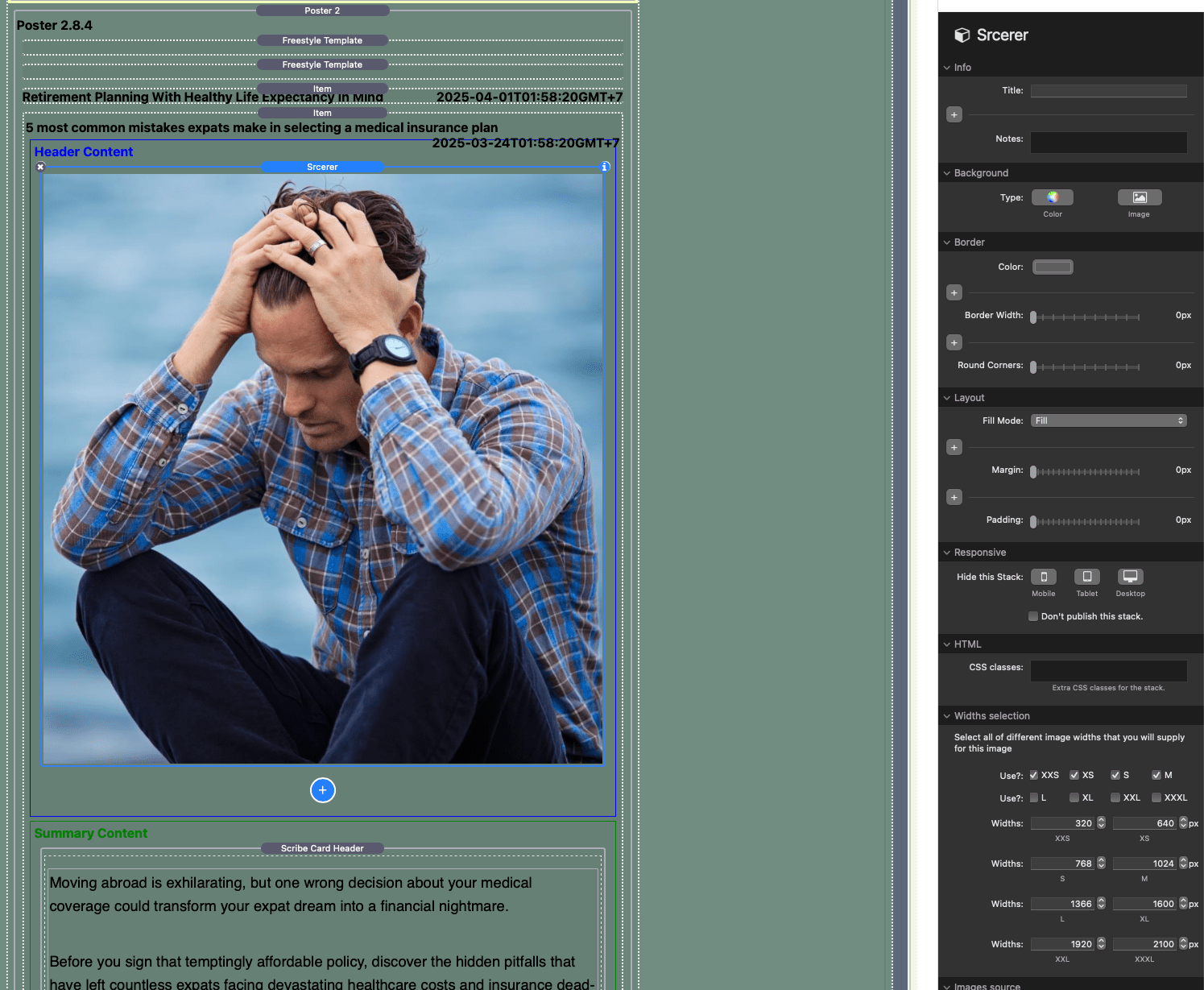

I want to use the Screrer stack (or the image stack) for images in the header part of the item in Poster stack but I can’t figure out how to “connect” the image in Screrer stack to “header.image.src” so that I can refer it in the Template.
Using the RW blog template (i.e. the default template) it works fine** with a Screrer stack in the header item but not when I use a freestyle template.

I have used the formula method (and that worked with the RW template but not freestyle). I used image fit in the template and {{header.image.src}} as the link.

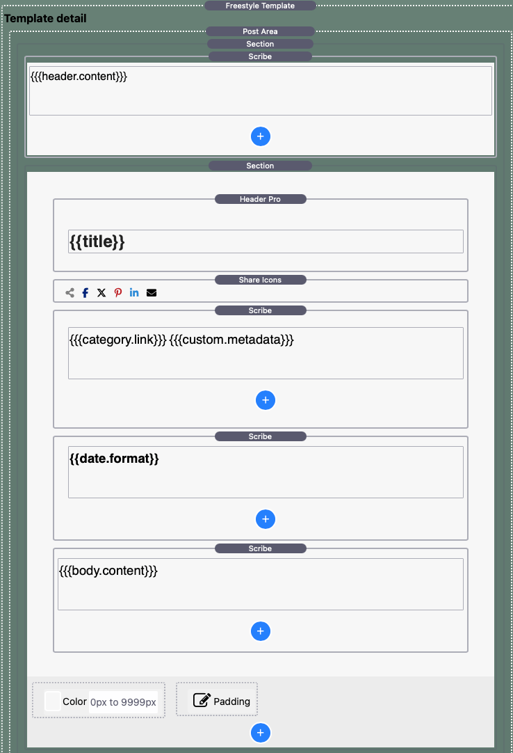

In my use case I have my template configured as below - trust this helps.
Hi @paul.rowe
Yes, thanks that was the clue. Going big and grabbing the whole thing instead of the image worked (together with the tripple “{{{}}}”)
