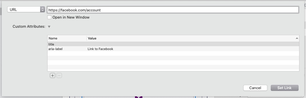

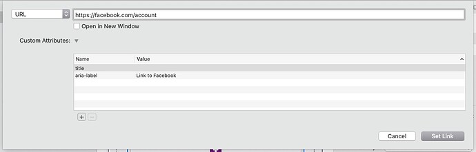

I created a general web design blog article questioning the need for so many icons and also adding in aria-labels to address Accessibility. The specific solution for Stacks users is to add the aria-label into the standard Link dialogue box as shown below for a Facebook icon:

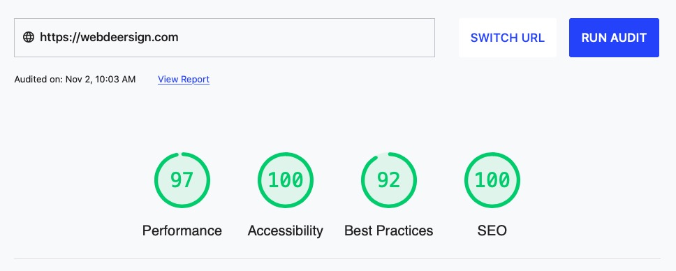

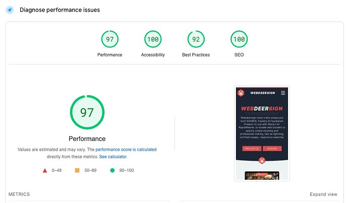

@tav I have been using both, quite a bit over the last 18 months or so.
They are now almost identical on a top initial level and both provide the information needed to build better web pages for speed, SEO and Accessibility. The results also match and hightligh the same issues that they both find. The Best Practices result seems a bit fickle in it’s results but may provide more meaningful data in the future.
I think PageSpeed Insights provides a more useful 2 pages or results, one for Mobile and a Desktop set of results which I find gives additional information. Generally, the mobile results drag the combined result down and IMHO achieving a 100% mobile result in the real world, requires some content butchery but still provides a most useful indicator.
The results for both effectively look the same after the resent changes in how they work.

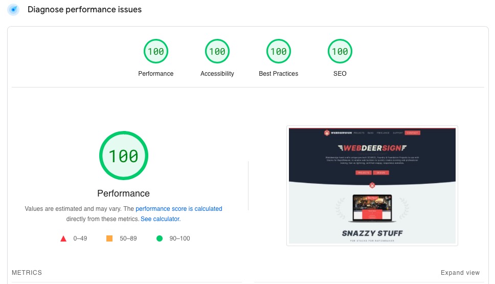

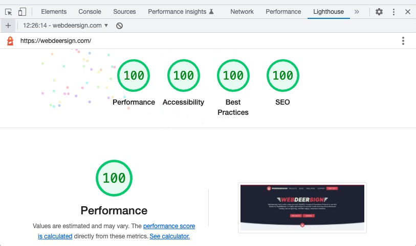

Lighthouse result below:
Lighthouse from inside Chrome Inspector, Desktop selected (note the twinky animated confetti):

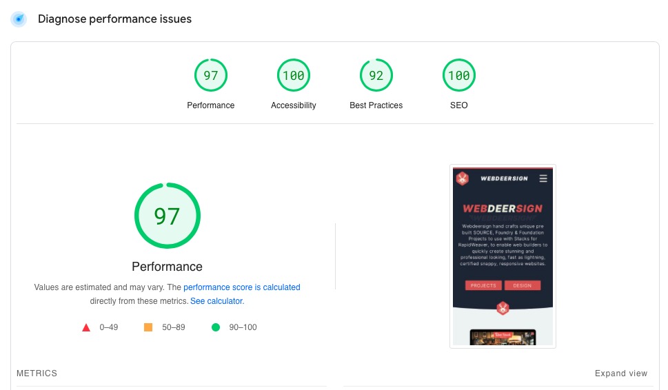

PageSpeed Insights Mobile result below:
PageSpeed Insights Desktop result below:
I just went on the Google specs and recommendations for the two services - they advise that Page Speed has no SEO component and it should be used for debugging and optimisation, Lighthouse should be used for final page/site analysis w.r.t ranking. Lighthouse also gives more image optimisation suggestions.
Given that we are talking about RW and that users will only be interested in testing for ranking / SEO purposes and optimising their visitor experience then I think that Lighthouse should be the recommendation to users of this forum.
The information that I see when I Google “Lighthouse” and their current reccomendations I see, are to use PageSpeed Insights which Google says incorporates Lighthouse. Web.dev suggests PageSpeed Insights.
My images above show the same SEO results for both so there certainly is (today) an SEO component. SOunds like Google specs are not up to date. Google can and do make some great stuff, but sometimes trying to navigate around them can be a quagmire of a puzzle.
