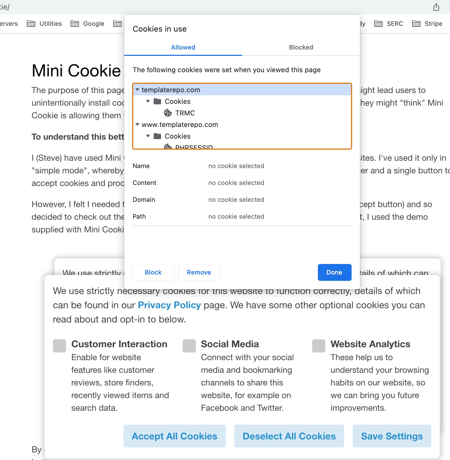

I discovered this issue a few weeks back and made a demo page, but forgot to do anything with it. So here it is, with more details of the issue and how to replicate it.
I have raised this âissueâ with the dev, but no resolution was come to, so I stopped using Mini Cookie.
Demo: minicookie | My Website

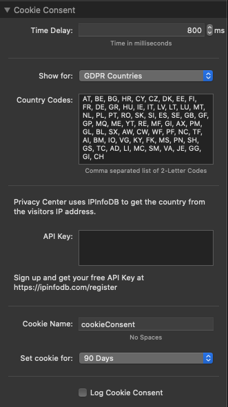

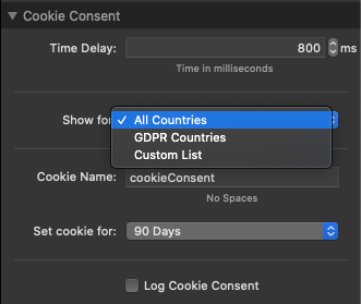

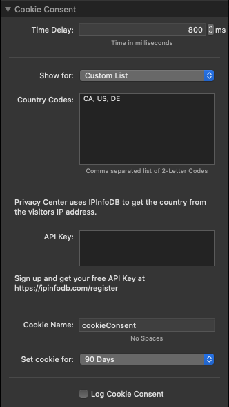

Privacy Center can do that.
Also, Privacy Center can detect the browser language and show a multilingual version.

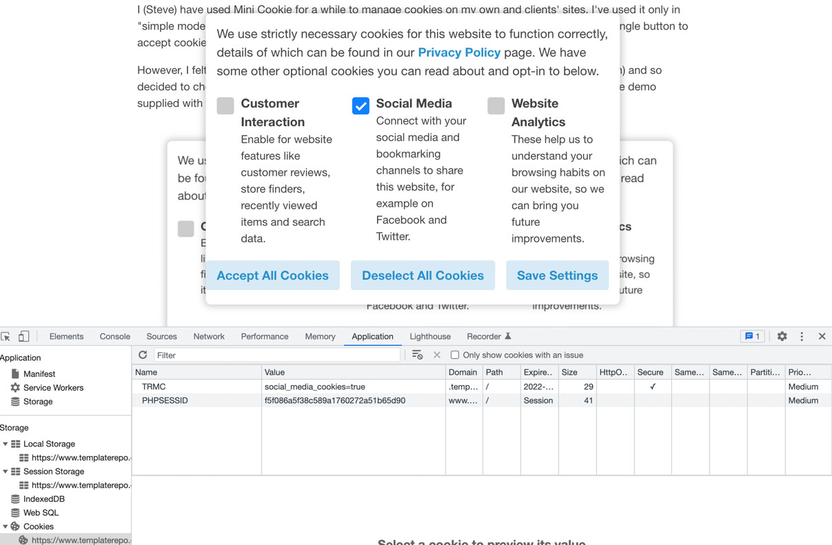

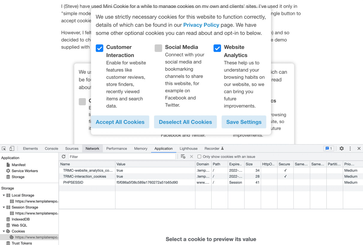

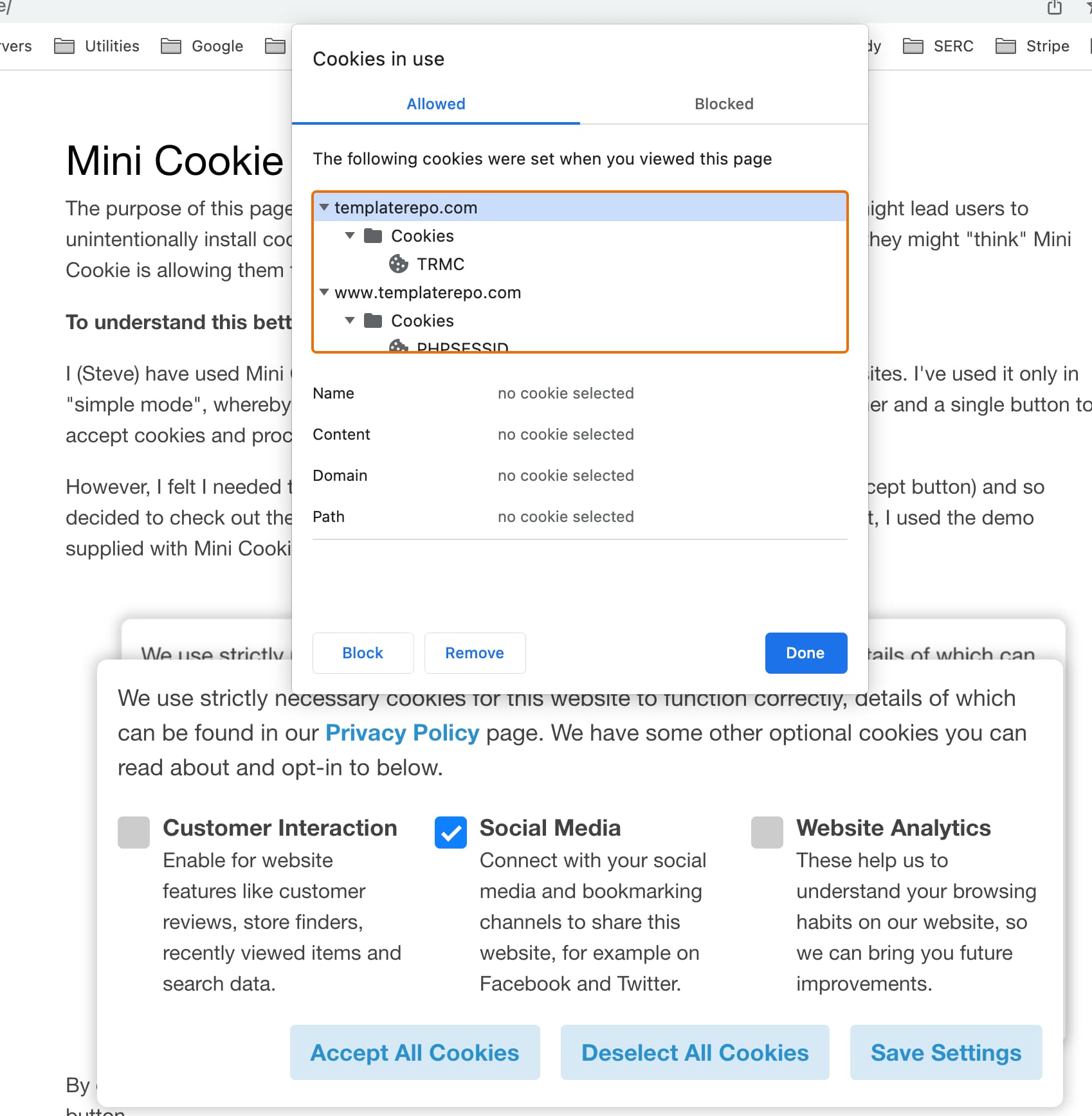

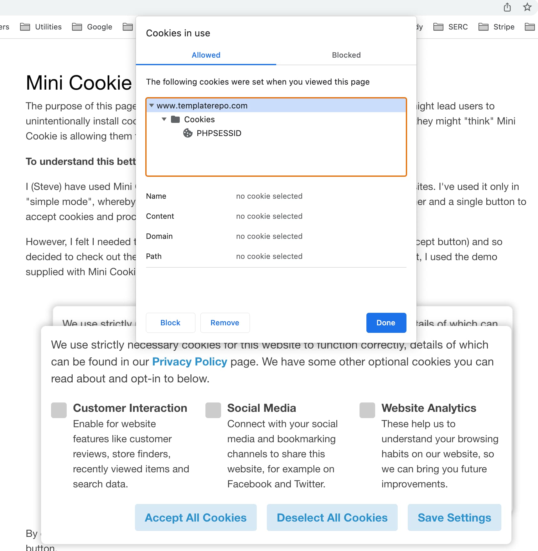

Cookies are installed when you click the checkbox, but they are not deleted when you uncheck it. That is the crux of what I see as the problem.
Right, that is what I feared when reading your description. However, when I tested it with your demo page (MacOS Monterey, Safari), I saw the cookies appear and disappear based on the status of the respective checkbox.
I had opened the web inspector and there the cookie list. When I checked a box the cookie appeared, when I unchecked it and refreshed the cookie list, the cookie was gone again. I needed to refresh the cookie list to see the update, though. Maybe I was mistaken and the ârefreshâ deleted the cookie and not the website ? The ârefreshâ of course is not a âdeleteâ as the refresh indeed showed the selective presence or absence of any combination of the three cookies.
Thatâs interesting, as it isnât the behaviour I see when using Chrome. Ticking the box installs the cookie. If I then unclick it, the cookie is still installed.

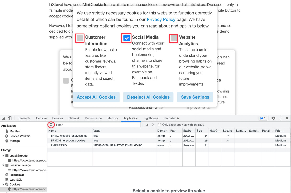

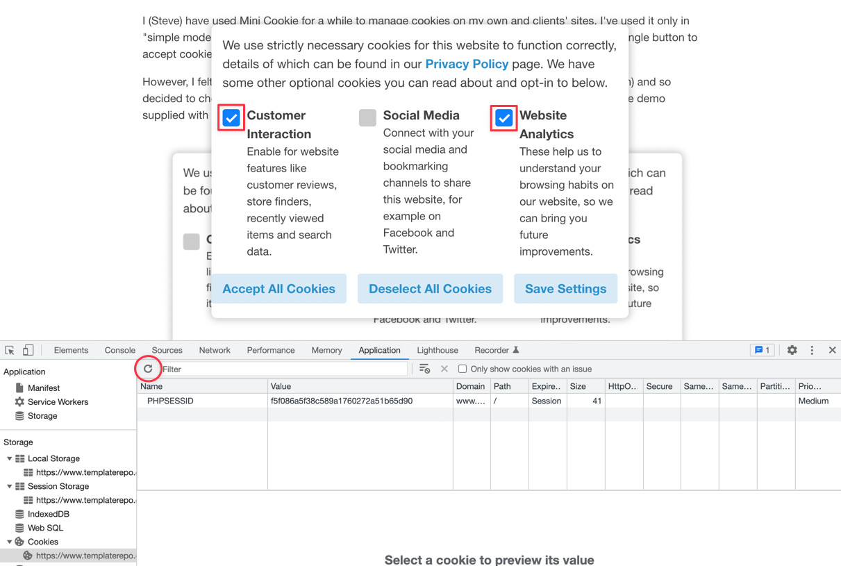

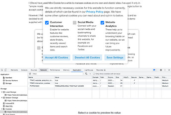

When I tried it on Chrome here, it behaves like what I saw with the Safari browser. All seems to come down to refreshing the cookie display in the browser to see the current status:
1) Calling the testsite, selecting two cookies, but not yet updating the cookie list
- The same situation after refreshing the cookie list - now the cookies are shown, i.e. they have been written as soon as the checkboxes have been selected:
3) Changing the selection, but not yet refreshing the cookie list - the old cookies are still displayed
- Finally refreshing the cookie list again, and the list reflects the new choice, i.e. the cookies have been written or been removed as the checkboxes are changed:
Above screenshots were taken with Chrome (V99.0.4844.51). I see the exact same behavior with Safari (V15.3 (17612.4.9.1.8)). I very much appreciate all the extra work done to demonstrate and discuss this topic - one of the strengths to have such an independent forum available. It is not my intention to argue for one or the other stack, just trying to avoid that we accidentally make wrong claims about a stack or doing injustice to any developer out there. ⌠and all with the disclaimer, that I am not a developer and have no expertise in browsers. It is merely an observation and my interpretation ;)
You are correct. It does seem to depend on a page refresh. As you say, if you tick, then untick the cookie remains installed, but a refresh clears it.
Iâve updated the test page to use a conditional stack that installed some tracking code from matomo, itâs connected to the âWebsite Analyticsâ option in the cookie manager. And this does work. In that, even if you click the option, then unclick it, the tracking code isnât installed.
So contrary to my initial findings/thinking the multi-cookie option does work, of a fashion. Iâm surprised the dev didnât tell me the crucial bit about the page refresh to clear the ticked/unticked cookies.
There is still the outside chance someone will click the website analytics option, then refresh the page before clicking save, at which point the tracking code is installed, then unclick the website tracking option, then click save. Whereupon the tracking code will still be there. But this really is a corner case, and really, Iâm splitting hairs!
I suppose from my point of view, though, I have to say, I still feel the way it works is a bit wonky. Surely itâs far better to have nothing installed until the save button is clicked? But great work @GKs at getting to the bottom of this for me, and possibly others. This is definitely one of those instances where Iâm pleased to be found wrong.
