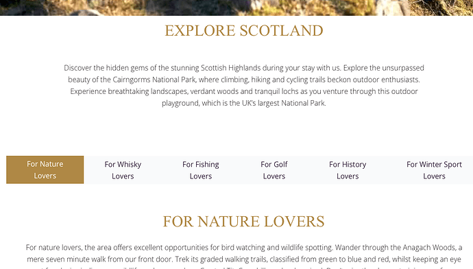

I’m not sure what this is called, so please indulge me here…
This not a top menu, but half way down a page.
If I click on ‘For Whisky Lovers’ or ‘For Fishing Lovers’ new page content is loaded below the switcher. Is there such a product for RW / Stacks? Is this a dated design?
Recommendations gratefully received!
