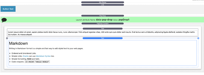

Looks like this…

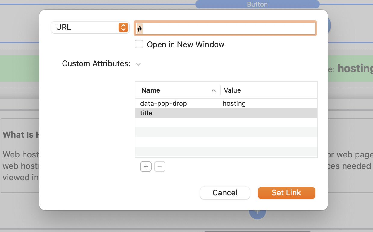

Well your works on my page when I change the attribute but mine doesnt for some reason. That’s weird. Thanks a lot anyway, I’ll avoid the F6 link button then. cheers
Strange. It refuses to work with any of my buttons but it does with yours with the same settings.
Fire me a project over. See if also happens that way for me.
@aidy I’m pretty sure your problem will be that stack settings links do not support data attributes.
When you click the orange link button from text the RW link dialog will work and will add your data-pop-drop attributes that you enter.
If you open the RW link dialog from the stack settings (HUD in old money) then any attributes that you enter will be lost. This is why I added an attribute setting to button plus originally. Many other buttons now allow custom attributes which will also work. (This problem is outlined on the demo site home page under “Launching”. That refers to Foundation1 buttons because at the time that was the only mainstream framework in use.)

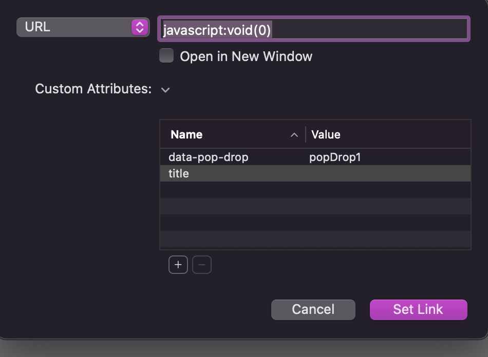

Afternoon @tav
In that example I did above, it’s using the bog standard S4 button. Adding the attribute in the way displayed in the image works.
Does that confirm or contradict what you said above?

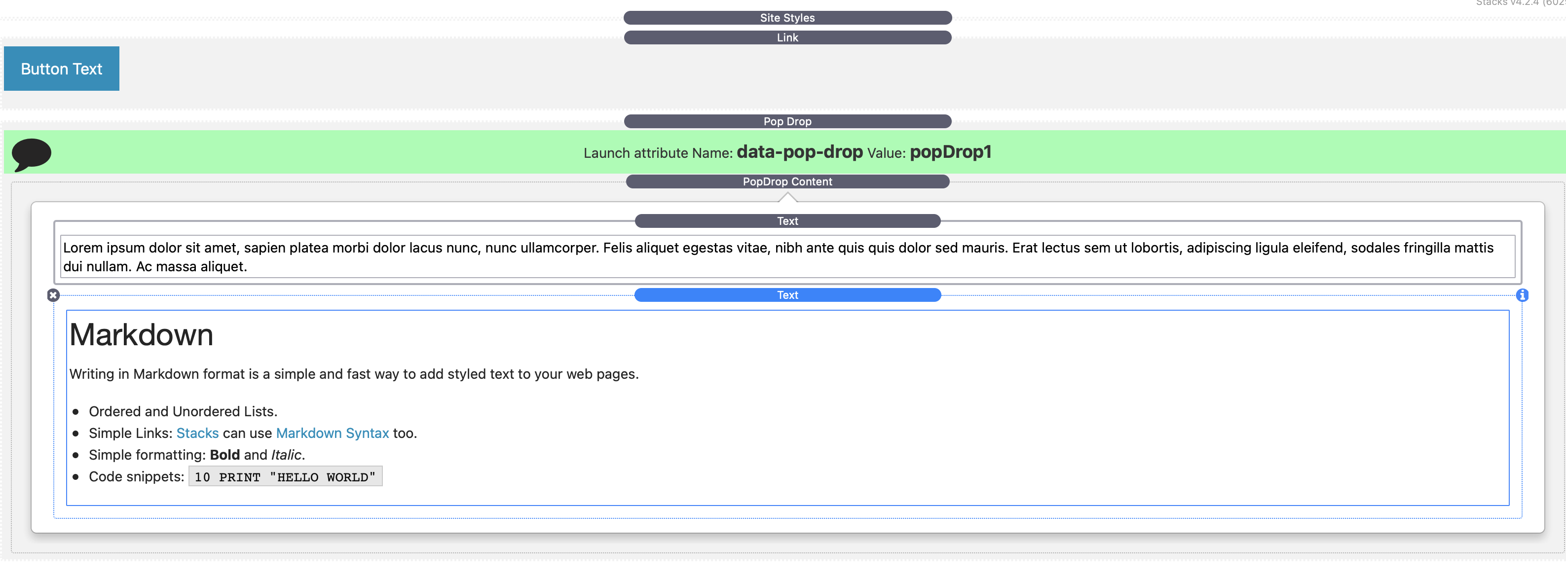

Here is an F6 project with 3 buttons all launching a pop drop as expected:
- BP2 using custom attributes
- BP2 using pop drop child
- F6 Button using custom attributes.
BP2 Popdrop child. Damn. I said I was out of touch. It’s been 2 years. That does the trick Thanks to you both for the help and the project
