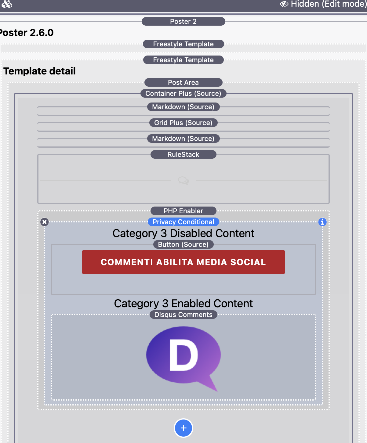

Hi everyone, I have a problem to solve.
I have this situation in Poster2 → TEMPLATE DETAIL-> POST AREA:
I would like Privacy Center (category 3) to enable the “Disqus Comments” stack via Privacy Conditional.
Unfortunately the only result is the disappearance of all posts.
Do you have any suggestions?
I guess I need to have a deep look. If you could send me the project? I don’t have Privacy Center, so please ask the dev before if you could send me this stack also.

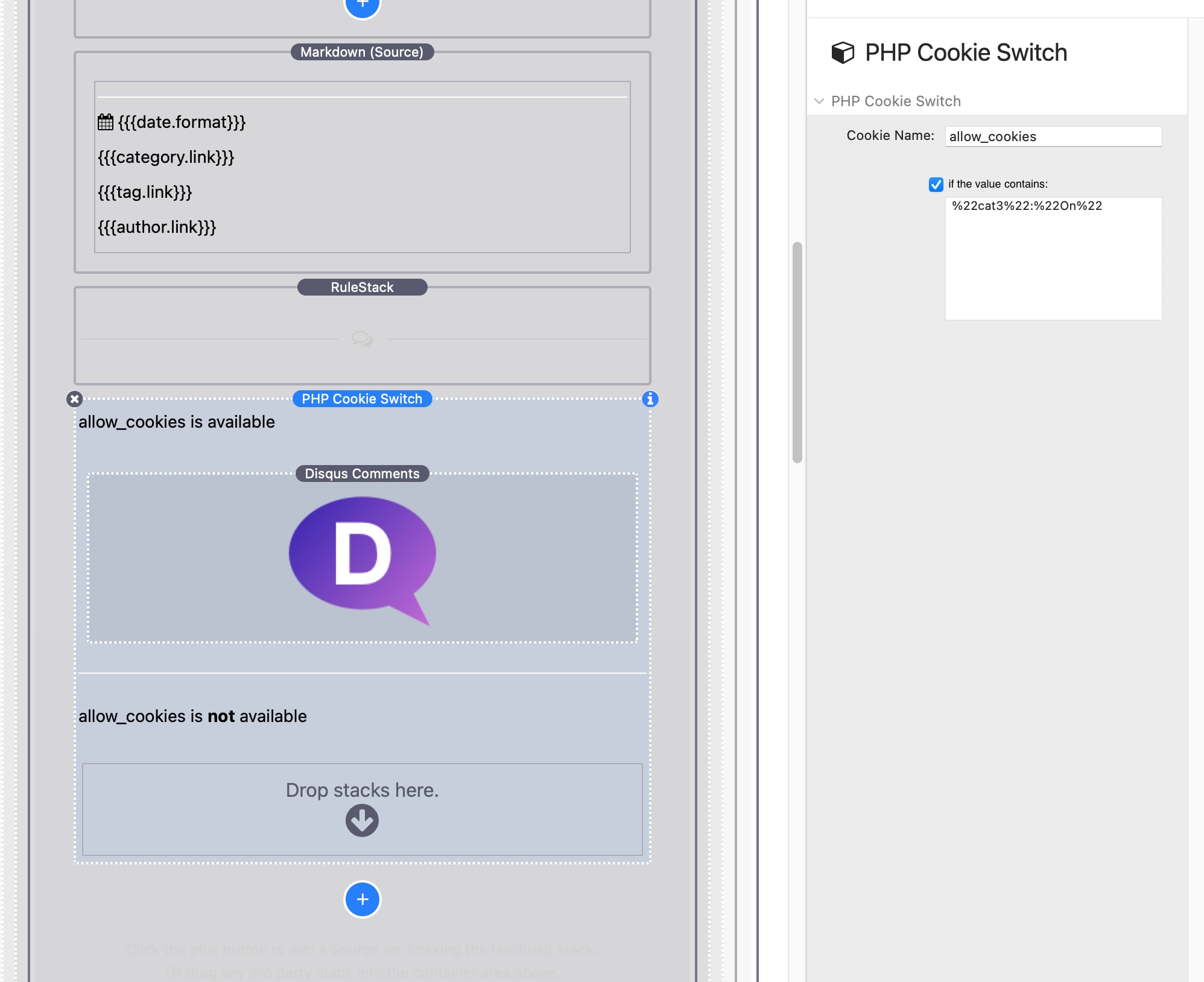

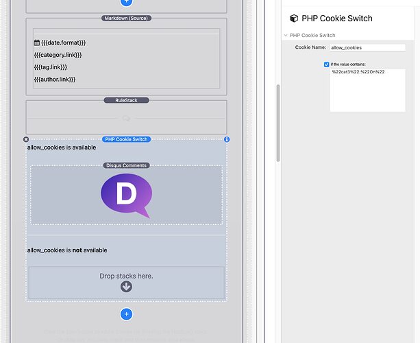

Considering your PHP Cookie Switch stack - which works perfectly - could totally solve the problem even in different situations in the future, that is
by integrating in PHP Cookie Switch an “if value contains”, in this case the content is displayed if the value of the cookie contains the string fragment.
In the case of my project (example) if the value of the cookie (allow_cookies or another name) contains the following string
%22cat3%22:%22On%22
PHP Cookie Switch displays the content of “available” (displays the comments of Disqus) otherwise the content of “not available” (a button to consent to the disqus cookies) is displayed.
Could this be the solution?
Yes, I can add such an additional value check for the cookie. Good idea. Give me some days.
You are great, thank you very much
If I’m not mistaken, the Disqus Comments Stack can be added outside of the post area, as it saves and loads comments based on the page permalink.
Therefore, the Privacy Conditional Stack should also be outside the post area and not require the PHP Enabler.
Hi Kennerty, first of all I want to congratulate you for the excellent Privacy Center stack and for its simplicity and for how it works, the speech of placing a conditional Stack in the post only concerns its position within the post (if I insert only the Disqus script in a Privacy Center script works perfectly and is displayed on every page, or even as a Privacy Conditional stack outside the post area works).
