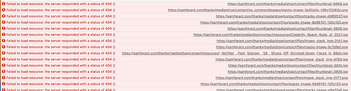

If you look in the browser console, you’ll see a lot of files 404-ing, including the css files.
The folder that is 404-ing, is rw_common/files/files
Now, normally, there shouldn’t be a subfolder called 'files’inside rw_common, let alone another folder called ā€˜files’ inside files, so there’s something amiss in that department.
The files folder, containing all css and more, should be directly in the root (for the home page) and in each subfolder for pages that you create. But NOT in rw_common.
Have you moved stuff using a file manager? Or tried to force the location of files from within RW?
To be sure, try republishing all files (RW > File > Re-publish all files) after you delete everything from the public_html folder.
If the problem persists, the cause must be in your project file. If that’s the case, why not share it here (as a zipped file) so we can have a look at it?
