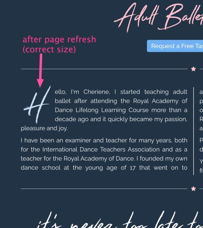

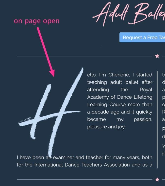

Do you have any idea when this page first opens the drop cap is too large, yet when the page is refreshed it displays as intended. I have attached two screen grabs showing the issue.
Thanks
Richard Bailey
Morning Richard,
That is caused by the Javascript running before the page has fully loaded (i.e. if doesn’t know the true size of the space that it needs to occupy).

Does it do it with system fonts or is it related to the loading time of your Stay Rad font from your server? I wonder if the font is not loading locally as fast as the page is rendering and hence the drop cap calculation takes place before the font is in place. This could explain why it would work on a page refresh.

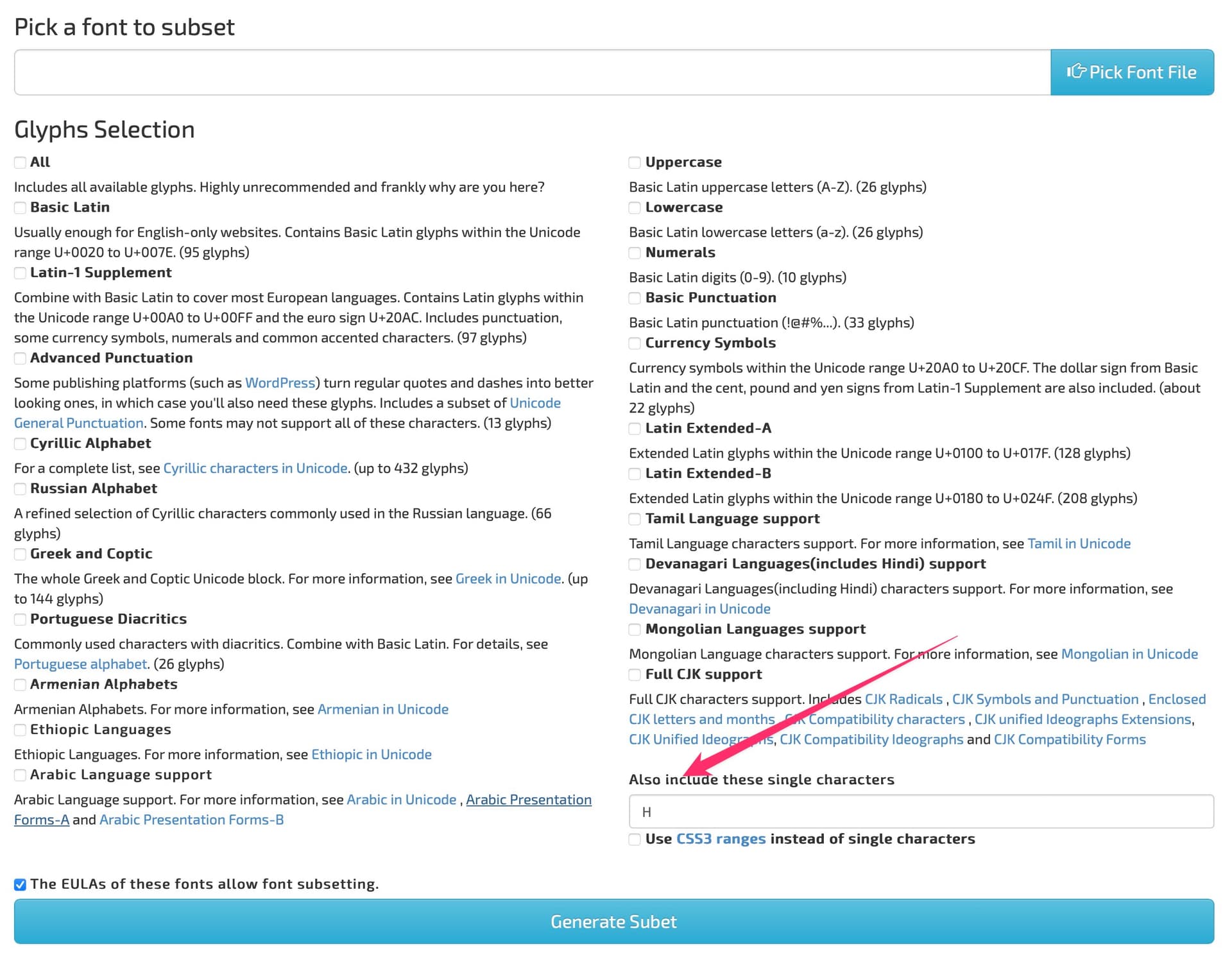

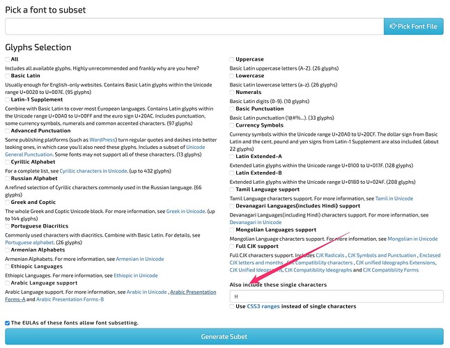

Step 1: Maske a subset of the font
  • Make a new font with just the characters you need for drop caps in it - you can still load the whole of the existing font if you need it elsewhere
(This is a good way to reduce the size and loading times of fonts that are large though in many use cases)
In this case I’ve shown it with just the letter H in an new font and everything else deselected.
Do it here (there are many others if you google it) : Font Subsetter

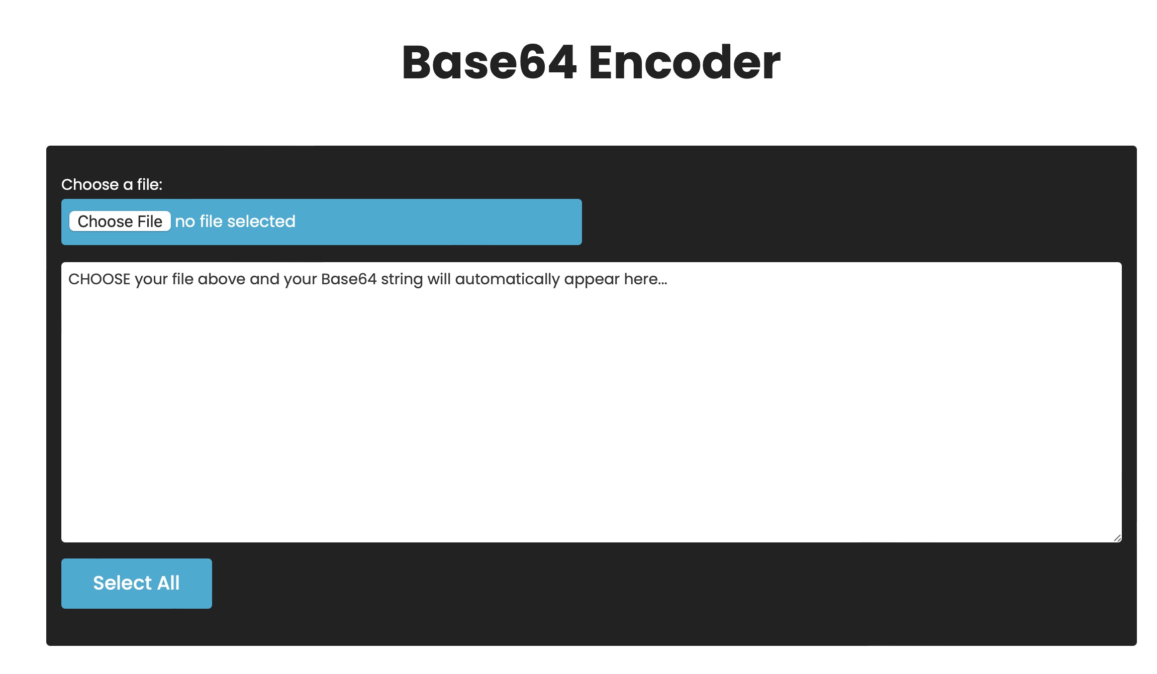

Step 2: Turn your new font into a base-64 encoded text file
Put your newly created one letter or small font font though a base-64 encoder like this one
The base-64 text will appear in the big white box - copy this text to your clipboard

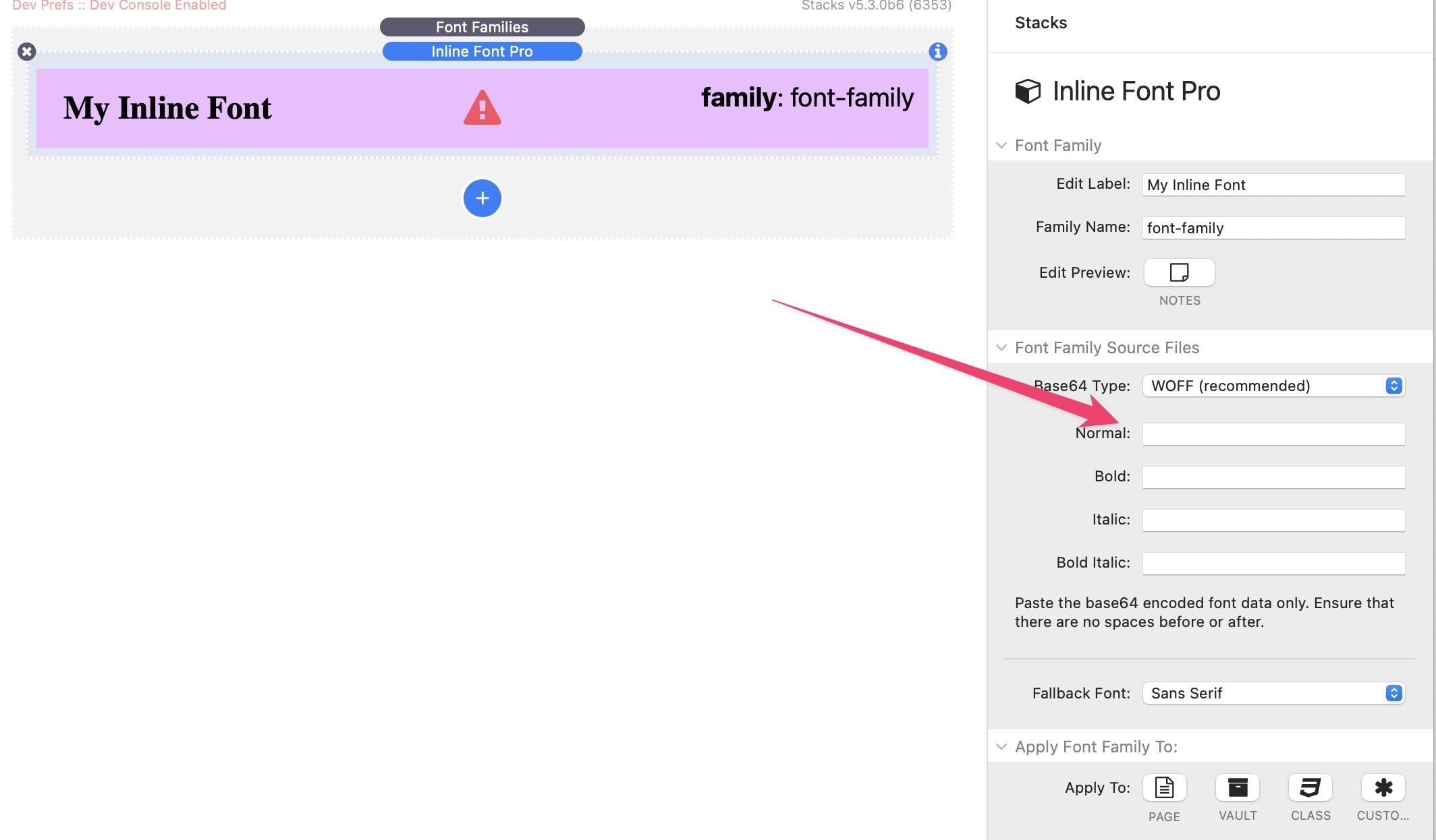

Step 3: Add the new font*
Using the Font Pro > Font Families stack add a new Inline Font
In the setting for the Normal typeface, paste in your newly generated Base-64 encoded font
Give the font a unique name in Font Pro or add it to a vault just like you normally would and use it knowing that it will load at the same time as the HTML

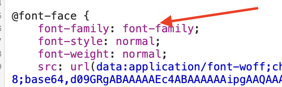

That page is not using the base64 inline font for the drop cap. It is still using the Stay Red font loaded as a WOFF from your server.
The inline font appears not to have been given a font family in the FontPro inline font settings as the font family is coded as “font-family” - this should be the new name that you define in the settings:

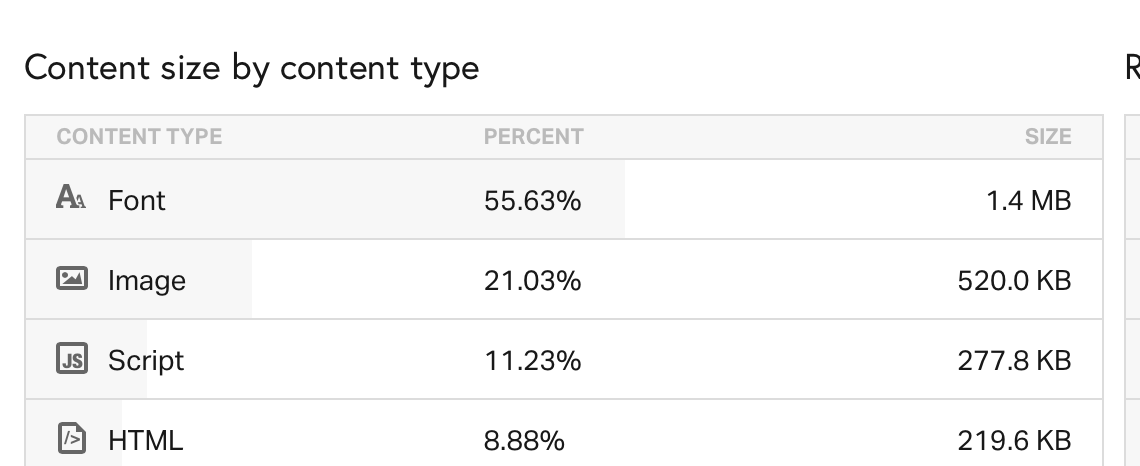

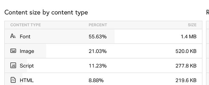

Your page is loading an enormous amount of fonts :
29 variants of Raleway
Advent Pro
Stay Red
Do you really need so many fonts?
They total 1.4MB and are over 1/2 of the total page size.
