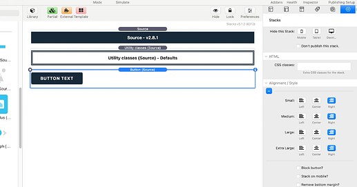

Source buttons do not respect right alignment in Small and Medium situations

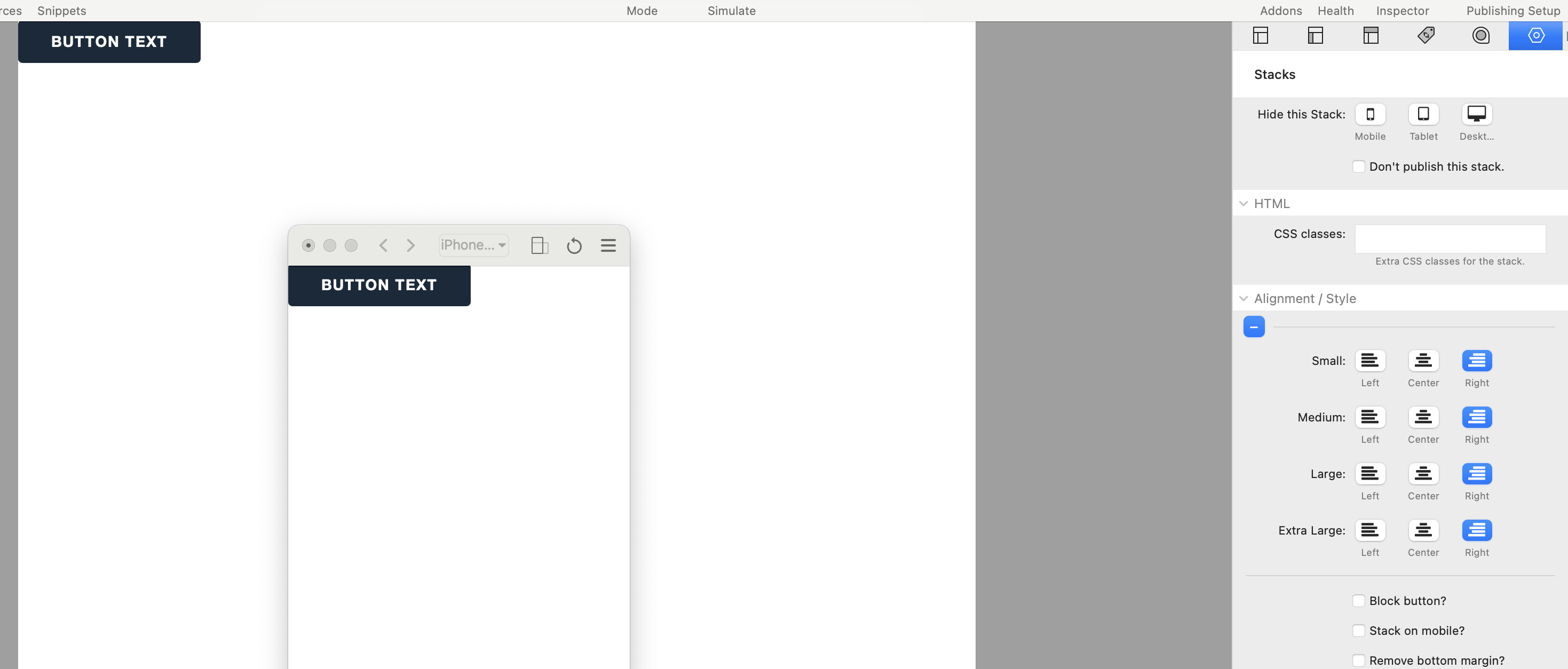

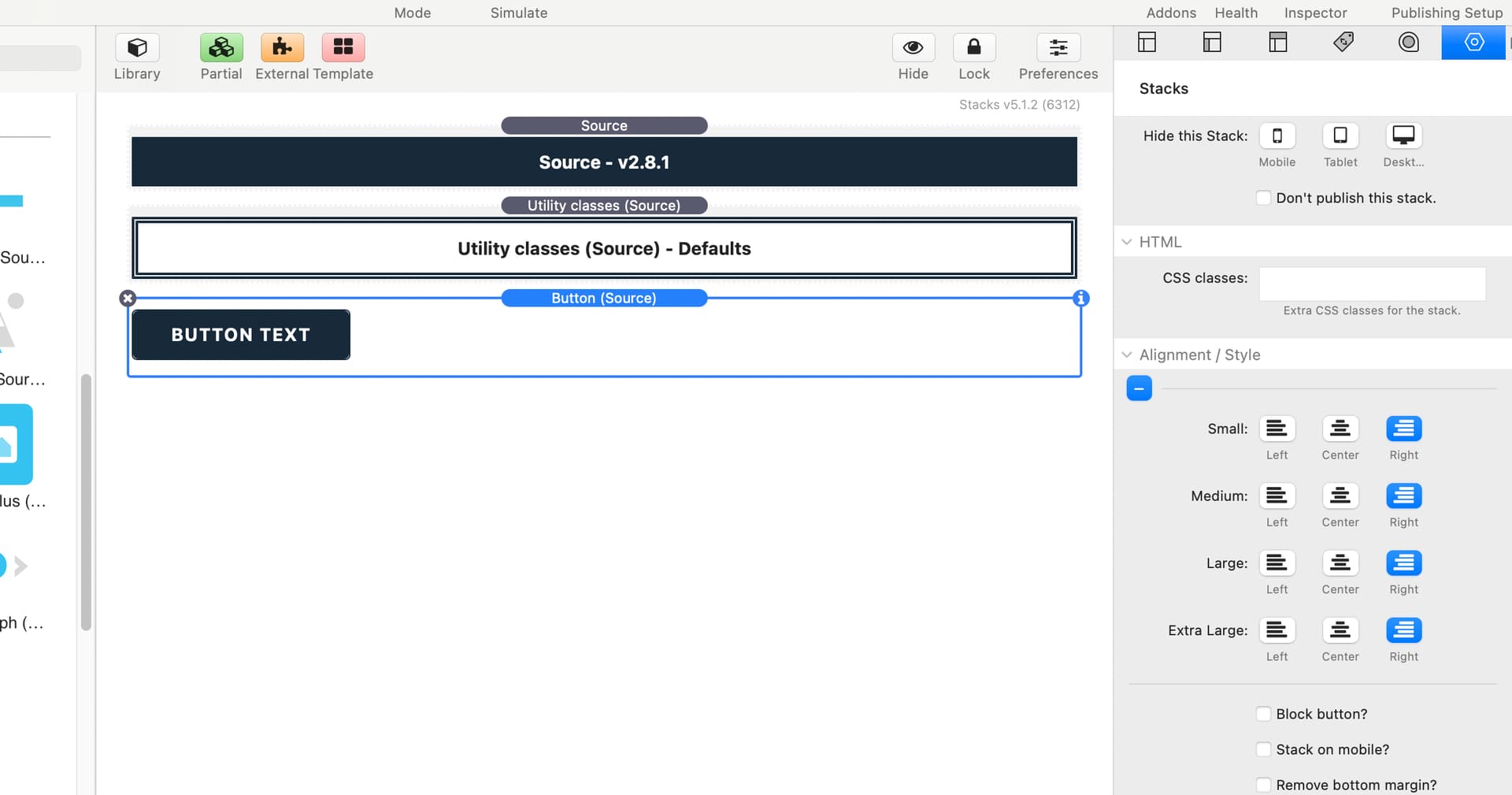

I have a problem with the Source buttons, they don’t respect the right alignment in the Small and Medium situation.
I had never noticed why I usually always position the buttons in the center, but for a couple of days I have needed to position 3 buttons depending on the breakpoint on the right, center and left…
I’m going crazy…
I also tried on my other projects, the right alignment of the button doesn’t work in Small and Medium.
If it’s just my problem, I don’t know how to fix it.
If it’s a common problem, can it be solved?
Thank you
I can confirm the behavior on my system, too. The button on ‘small’ only honors ‘left’ and ‘center’ - ‘right’ ends up on the left. The button on ‘medium’ seems to work properly - unless the ‘small’ setting is on ‘right’ … ;) Could be a typo in the variables, I am sure, Stuart can fix it in a moment.
How odd. i must have broke it at some point. Will get a fix out later today or (more likely) tomorrow.
In the meantime you could use a single grouped button as the alignment options for that should work fine.

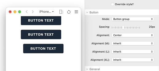

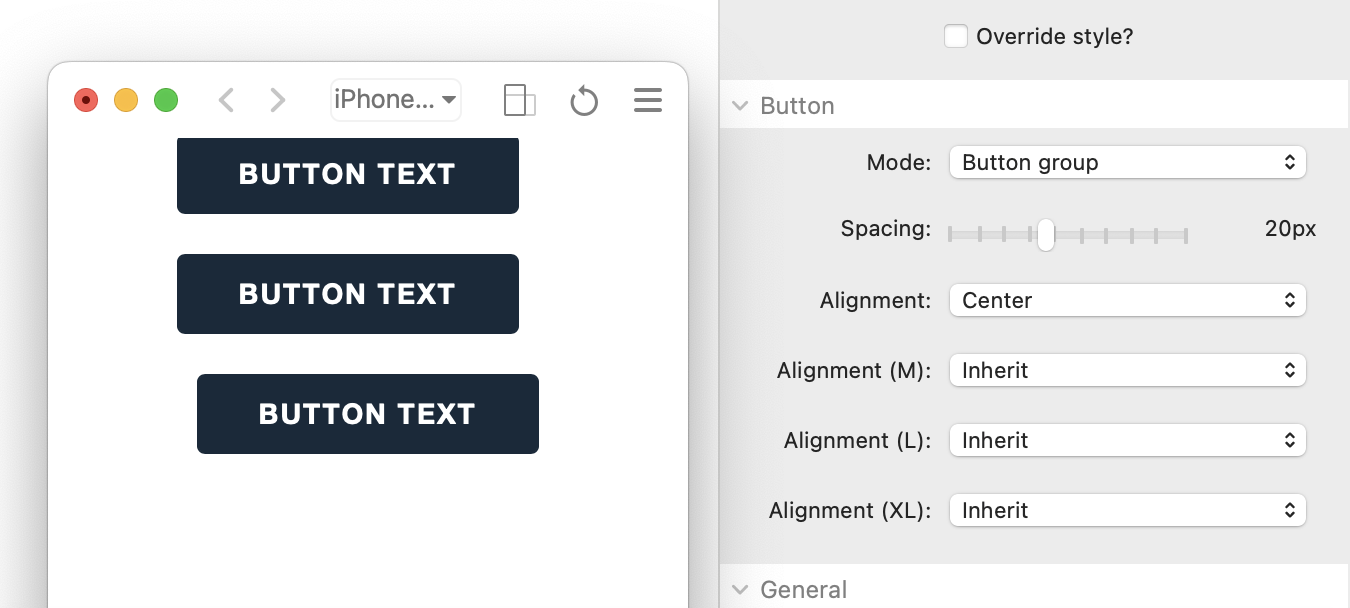

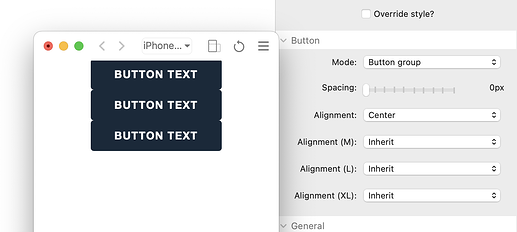

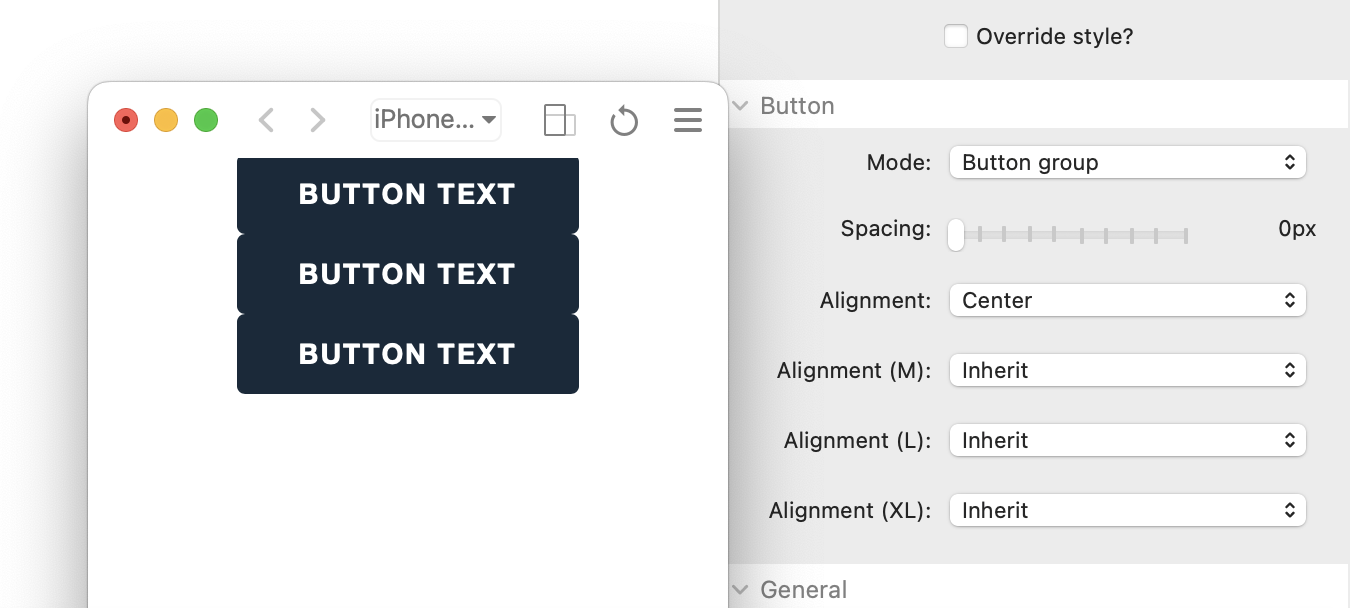

Unfortunately with the grouped button, if I increase the spacing, there are alignment problems in the Small situation (to align them I would have to put zero spacing, too attached)
Hi @Lukh - v2.8.2 should sort this issue. Available via the Stacks updater now.
Thanks, it’s perfect now.
Faster than light…
Thanks again
