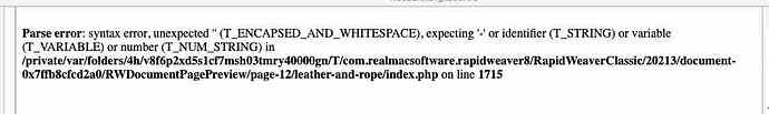

I use the Agent stack (Weaver space) to be able to have two languages in my pages. That has worked fairly well but when I use it inside a poster2 item it does not work. I get the error
Since I realized the Agent stack is php I put it inside the PHP enabler and then the error disappeared but then the macro that is also used together with the Agent stack to translate words and other short stuff stopped working. The macro look like this %lang(sv:Nummer,en:Number)% and displays like that instead of “Nummer” or “Number”.
Anyone seen this?
/Erland
The PHP enabler stack is just a workaround, which works in some circumstances, but not in all. I doubt these two stacks will work in combination like you are trying currently.
ok sad news. But why does the php enabler stop the macro that is outside the enabler, even outside the poster stack like in the menu, from working?
Note that with the enabler, the Agent stack seem to work inside a poster item but turns the macro “off” all over the page.
without the enabler the macro works fine everywhere, also inside a poster item.
/Erland
