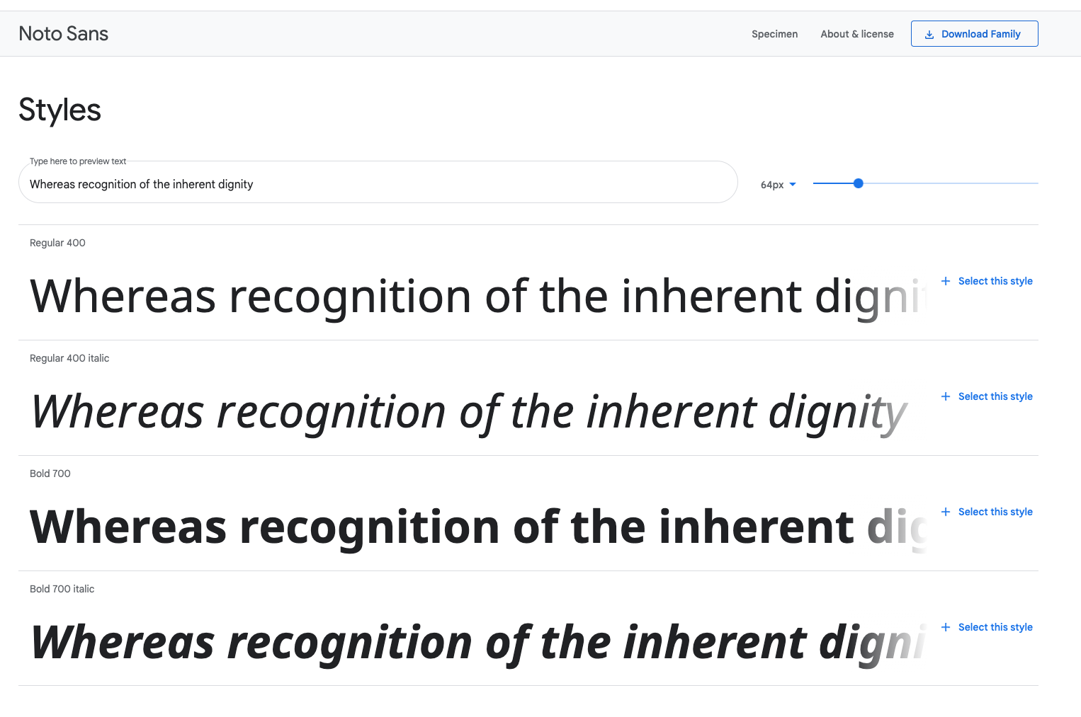

I just wonder why they have only 4 weights/styles available. I have TTF files for the same font that include 72 weights/styles (just for Sans). Same situation with Serif. At the same time, they have 9 weights for Noto Mono. Of course, I do not need all 72 varieties…
That https://google-webfonts-helper.herokuapp.com/fonts site is not a Google site and appears to be a selection of Google fonts donloaded in a selection of weights and styles, chosen ny the creator of that site.
There only are 4 styles available for that font on the Google site:
That’s surprising, because FontSquirrell website still has 72 styles, for both NotoSans and Noto Serif – including Thin, ExtraLight, Light, Regular, Medium, SemiBold, Bold, ExtraBold, Condensed, ExtraCondensed and SemiCondensed. But only one style for NotoMono.
